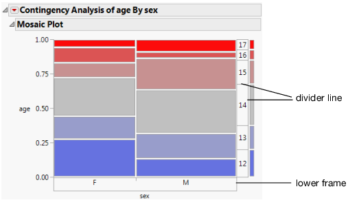

Extend Divider Lines and Frames for Categorical Axes
Extending the vertical divider line(s) between tick labels is useful when there are many levels of a nominal or ordinal (categorical) variable.
To extend the divider line to the x-axis labels, follow these steps:
1. Right-click a nominal or ordinal axis.
2. Select Tick Marks > Divider Lines to add the lines, or Lower Frame to add a frame around the axis area.
Figure 9.31 Divider Lines
