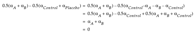

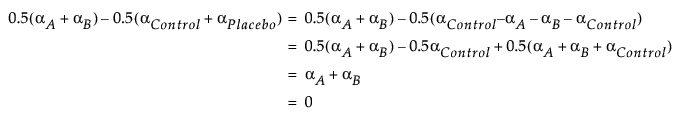

• Compare treatments A and B to the control and placebo groups:
To obtain contrast coefficients for this contrast, you need to write the placebo effect in terms of the model effects. Specifically, use the fact that . Then . It follows that:
