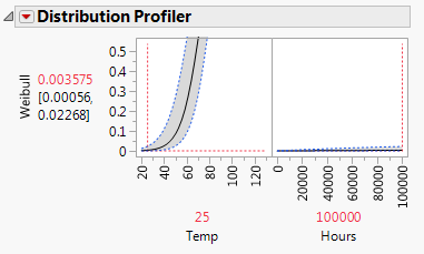

3. In the Distribution Profiler, found in the Comparisons outline on the Distribution tab, do the following:
– Click 105 above Temp and change it to 25.
– Click 750.5 above Hours and change it to 100,000.
Figure 22.10 Distribution Profiler for Capacitor Model
Based on your current study, the predicted fraction of the population that fails at 25o at 100,000 hours is 0.00358, with a 95% confidence interval of 0.00056 to 0.02268. You want to estimate the failure fraction more precisely. To decrease the width of the confidence interval, you can augment your study with additional tests.

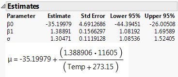

10. Under Prior Mean, select Specify Intercept.Enter the acceleration model parameter estimates from the Fit Life by X Estimates outline, found in the Weibull Results outline on the Statistics tab.
Figure 22.11 Parameter Estimates and Fitted Model from Weibull Results Outline
– Enter -35.200 for Intercept.
– Enter 1.389 for Activation Energy (Temp).
This is an estimate of the activation energy and is the coefficient of the inverse temperature, measured in degrees Kelvin, multiplied by Boltzmann’s constant.
– Enter 1.305 for scale.
For the Weibull distribution, JMP uses a parameterization that depends on a location parameter μ and scale parameter σ. In terms of the usual α and β parameterization, the scale parameter is σ = 1/β. See Weibull.

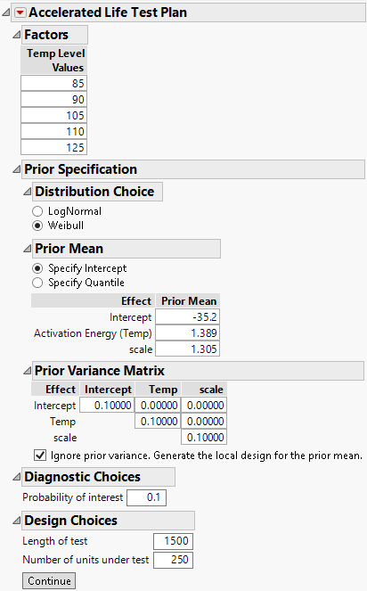

In the Accelerated Life Test Plan window, you can specify uncertainty about your prior means in the Prior Variance Matrix outline. In this example, do not make any changes to the Prior Variance Matrix outline. Your design is created assuming that the values specified in the Prior Means outline are the true parameter values.
11. Under Design Choices, enter 1500 for Length of test.
The test is conducted over 1500 hours, which was the length of the original design.
12. Enter 250 for Number of units under test.
The previous experiment tested 150 units, and the augmented experiment tests an additional 100 units, for a total of 250 units.
