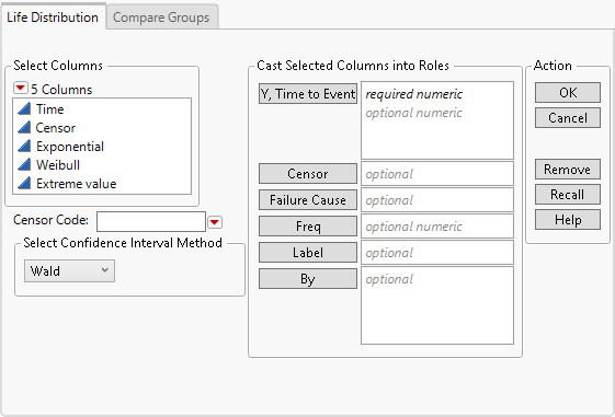

Launch the Life Distribution platform by selecting Analyze > Reliability and Survival > Life Distribution. For more information about the options in the Select Columns red triangle menu, see Column Filter Menu in Using JMP.
Figure 3.4 The Life Distribution Launch Window
Launch Window Tabs

The launch window contains the following options:
Y, Time to Event
One or more response columns. The number of response columns specified depends on the censoring structure in the data table.
– If one variable is specified, it is interpreted as the time to event (such as the time to failure) or time to right censoring. Use the Censor column to indicate right-censored responses. For more information about right censoring, see Single Time to Event Column.
– If two variables are specified, they are interpreted as interval-censored observations. The first Y variable gives the lower limit and the second Y variable gives the upper limit for each unit. For an example of using two response columns to represent various types of censoring, see Figure 3.5. For more information about censoring with two response columns, see Two Time to Event Columns.
Figure 3.5 Censored Data Types for Two Response Variables
– If three or more variables are specified, the report contains a separate analysis computed using each specified variable as time to event data.
Grouping
(Appears only in the Compare Groups tab.) A column containing the groups that you want to compare. For an example, see Examine the Same Distribution across Groups.
Censor
A column that identifies right-censored observations. Select the value that identifies right-censored observations from the Censor Code menu beneath the Select Columns list. The Censor column is used only when one Y is entered.
