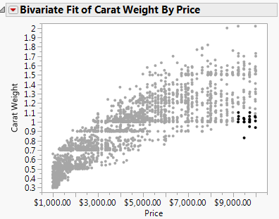

6. Select Tools > Lasso.
If you cannot see the menu bar, place your mouse pointer over the blue bar below the title bar to reveal it.
7. Lasso some of the points near the 10,000 dollar price at the bottom of the plot (Figure 4.9).
8. In the data table, select Rows > Next Selected (or you can press the F7 key).
You can easily navigate through the selected rows to see the data for each.
Figure 4.9 Points Selected
