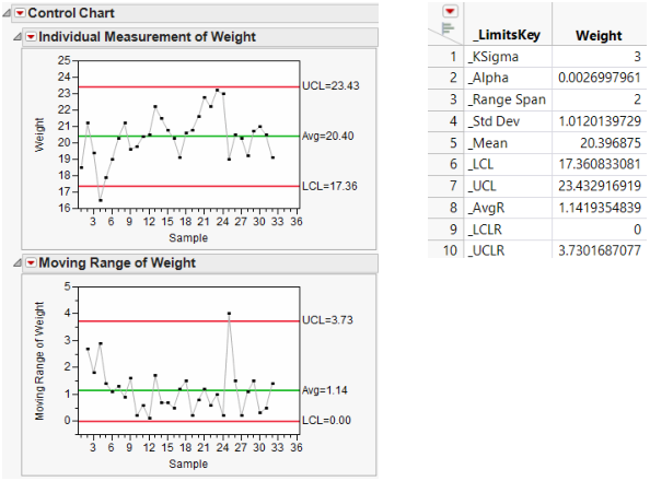

You can save limits in a new data table or as properties of the response column. When you save control limits using the in New Table command, the limit keywords written to the table depend on the current chart types displayed.
Figure 12.16 shows examples of control limits saved to a data table using Coating.jmp. The rows with values _Mean, _LCL, and _UCL are for the Individual Measurement chart. The values with the R suffix (_AvgR, _LCLR, and _UCLR) are for the Moving Range chart. If you create these charts again using this Limits Table, the Control Chart platform identifies the appropriate limits from keywords in the _LimitsKey column.
Figure 12.16 Example of Saving Limits in a Data Table
