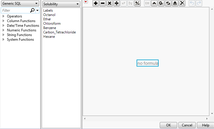

Use the WHERE Clause Editor
JMP provides help building WHERE clauses for SQL queries during ODBC import. It provides a WHERE clause editor that helps you build basic expressions using common SQL features, allowing vendor-specific functions. For example, you do not need to know whether SQL uses ‘=’ or ‘==’ for comparison, or avg() or average() for averaging.
In addition, string literals should be enclosed by single quotes (‘string’)rather than double quotes ("string").
To open the WHERE clause editor
1. Connect to a database by following the steps in Connect to a Database.
2. From the Database Open Table window, click the Advanced button.
3. Click the Where button.
USE the WHERE Clause Editor to add any of the following from the work panel: expressions, functions, and terms. They are applied to the highlighted blue box.
1. Click the Table Name Browser to select a table. The columns in that table appear in the list.
2. Click the SQL Vendor Name Browser to select the type of SQL that you want to use: GenericSQL, Access, DB2, MySQL, Oracle, SQL Server, or all of the above. Perform an action by clicking a function or operator in the list and selecting an operator from the list that appears.
Note: The following SQL Server data types are not supported: Binary, Geography, and Geometry.
3. Select an empty formula element in the formula editing area by clicking it. It is selected when there is a red outline around it. All terms within the smallest nesting box relative to the place that you clicked become selected. The subsequent actions apply to those combined elements.
4. Add operators to an expression by clicking buttons on the keypad.
5. (Optional) To customize your WHERE clause, select one of the options from the red triangle menu in the formula editor:
Show Boxing
Show or hide boxes around the WHERE clause terms.
Larger Font
Increase the font size of the formula.
Smaller Font
Decrease the font size of the formula.
Simplify
Simply the WHERE clause statement as much as possible.
Reset panel layout
Display the panels as shown in Figure 3.68.
The WHERE clause editor works similarly to the Formula Editor, which is described in Formula Editor.
