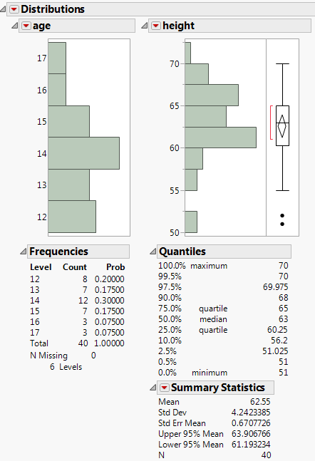

Follow the instructions in Example of the Distribution Platform to produce the report shown in Figure 3.5.
Figure 3.5 The Initial Distribution Report Window

The initial Distribution report contains a histogram and reports for each variable. Note the following:
• To replace a variable in a report, from the Columns panel of the associated data table, drag and drop the variable into the axis of the histogram.
• To insert a new variable into a report, creating a new histogram, drag and drop the variable outside of an existing histogram. The new variable can be placed before, between, or after the existing histograms.
Note: To remove a variable, select Remove from the red triangle menu.
• The red triangle menu next to Distributions contains options that affect all of the variables. See Distribution Platform Options.
• The red triangle menu next to each variable contains options that affect only that variable. See Options for Categorical Variables or Options for Continuous Variables. If you hold down the Control key and select a variable option, the option applies to all of the variables in the report that have the same modeling type.
• Histograms visually display your data. See Histograms.
• The initial report for a categorical variable contains a Frequencies report. See The Frequencies Report.
• The initial report for a continuous variable contains a Quantiles and a Summary Statistics report. See The Quantiles Report and The Summary Statistics Report.
