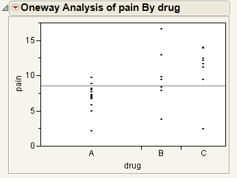

The Oneway plot shows the response points for each X factor value. You can compare the distribution of the response across the levels of the X factor. The distinct values of X are sometimes called levels.

To produce the plot shown in Figure 6.5, follow the instructions in Example of Oneway Analysis.
Figure 6.5 The Oneway PlotĀ
