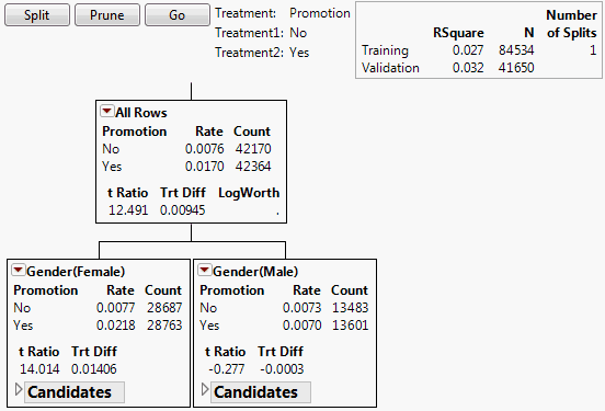

Uplift Decision Tree
The decision tree shows the splits used to model uplift. See Figure 6.4 for an example using the Hair Care Product.jmp sample data table. Each node contains the following information:
Treatment
The name of the treatment column is shown, with its two levels.
Rate
(Appears only for two-level categorical responses.) For each treatment level, the proportion of subjects in this node who responded.
Mean
(Appears only for continuous responses.) For each treatment level, the mean response for subjects in this node.
Count
The number of subjects in this node in the specified treatment level.
t Ratio
The t ratio for the test for a difference in response across the levels of Treatment for subjects in this node. If the response is categorical, it is treated as continuous (values 0 and 1) for this test.
Trt Diff
The difference in response means across the levels of Treatment. This is the uplift, with the following assumptions:
– The first level in the treatment column’s value ordering represents the treatment.
– The response is defined so that larger values reflect greater impact.
LogWorth
The value of the logworth for the subsequent split based on the given node.
Figure 6.4 Nodes for First Split
Candidates Report
Each node also contains a Candidates report. This report gives the following information:
Term
The model term.
LogWorth
The maximum logworth over all possible splits for the given term. The logworth corresponding to a split is -log10 of the adjusted p-value.
F Ratio
When the response is continuous, this is the F Ratio associated with the interaction term in a linear regression model. The regression model specifies the response as a linear function of the treatment, the binary split, and their interaction. When the response is categorical, this is the ChiSquare value for the interaction term in a nominal logistic model.
Gamma
When the response is continuous, this is the coefficient of the interaction term in the linear regression model used in computing the F ratio. When the response is categorical, this is an estimate of the interaction constructed from Firth-adjusted log-odds ratios.
Cut Point
If the term is continuous, this is the point that defines the split. If the term is categorical, this describes the first (left) node.
