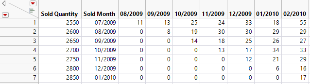

Contract data is commonly stored in the Nevada format: shipment or production dates and failure counts within specified periods are shaped like the state of Nevada. Figure 9.8 shows the Small Production.jmp sample data table.
Figure 9.8 Example of the Nevada Format

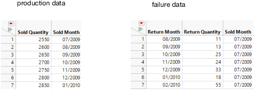

The Dates format focuses on production and failure dates. One data table specifies the production counts for each time period. The other table provides failure dates, failure counts, and the corresponding production times of the failures.
Figure 9.9 shows the Small Production part1.jmp and Small Production part2.jmp sample data tables.
Figure 9.9 Example of the Dates Format

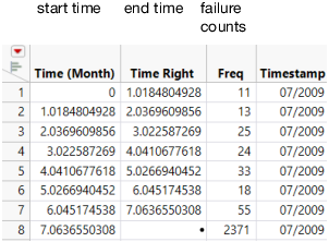

The Time to Event format shows production and failure data. Unlike the Nevada and Dates formats, Time to Event data does not include date-time information, such as production or failure dates. This format can also accommodate arbitrary censoring schemes in the data. See Defining Risk Sets with Time to Event Data.
Figure 9.10 shows the Small Production Time to Event.jmp sample data table. For an example that uses time-to-event data, see Additional Example Using the Reliability Forecast Platform.
Figure 9.10 Example of the Time to Event Format
