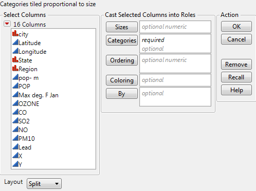

Launch the Treemap platform by selecting Graph > Legacy > Treemap.
Figure A.1 The Treemap Launch Window
Sizes
Determines the size of the rectangles based on the values of the specified variable. See Sizes.
Categories
Specifies the category that comprises the treemap. See Categories.
Ordering
Changes the ordering from alphabetical (where values progress from the top left to the lower right) to order by the specified variable. You can specify more than one ordering variable. See Ordering.
Coloring
Colors the rectangles corresponding to the levels of the specified variable.
– If the variable is continuous, the colors are based on a continuous color spectrum.
– If the variable is categorical, the default colors are selected in order from JMP's color theme.
See Coloring.
By
Identifies a column that creates a report consisting of separate treemaps for each level of the variable.
Layout
Determines the layout of the rectangles. See Layout.
After you click OK, the Treemap window appears. See The Treemap Window.
