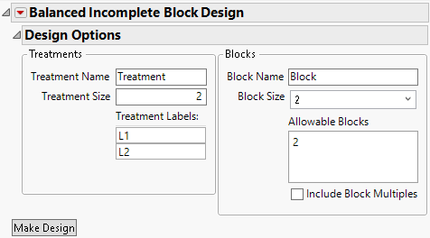

Build a Balanced Incomplete Block Design by selecting DOE > Special Purpose > Balanced Incomplete Block Design.
Figure 24.4 Balanced Incomplete Block Design Window
The Balanced Incomplete Block Design window updates as you work through the design . The steps to build a BIBD follow the flow in Figure 24.5.
