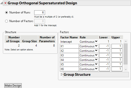

Build a Group Orthogonal Supersaturated Design by selecting DOE > Special Purpose > Group Orthogonal Supersaturated > Group Orthogonal Supersaturated Design.
Figure 26.2 Group Orthogonal Supersaturated Design Window
The GOSSD window updates as you work through the design . The steps to build a GOSSD follow the flow in Figure 26.3
