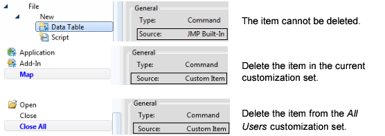

Rather than temporarily showing or hiding toolbars, buttons, menus, and menu items, you can delete items that you created to remove them permanently from JMP. The Source determines whether you can delete the item and which customization set contains the item. Figure 12.4 shows examples of customization Source types.
Figure 12.4 Examples of Customization SourcesĀ
