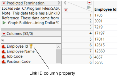

2. Open Predicted Termination.jmp from the Home Window’s Window List.
Notice that the Employee Id column has a Link ID column property.
Figure 6.44 Link ID Column Property

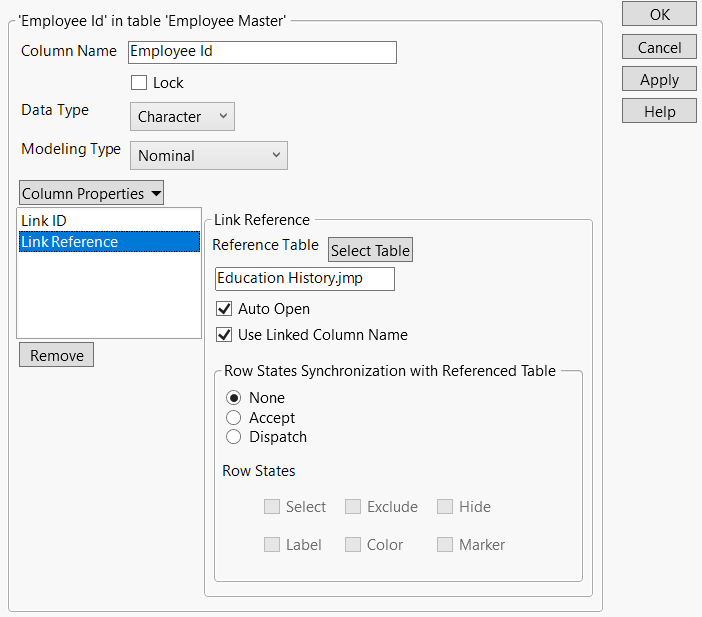

3. In Employee Master.jmp, select the Employee Id column and select Columns > Column Info.
Figure 6.45 Link ID and Link Reference Column Properties in Employee Master.jmp
Notice that the column has a Link ID column property and a Link Reference to Education History.jmp.

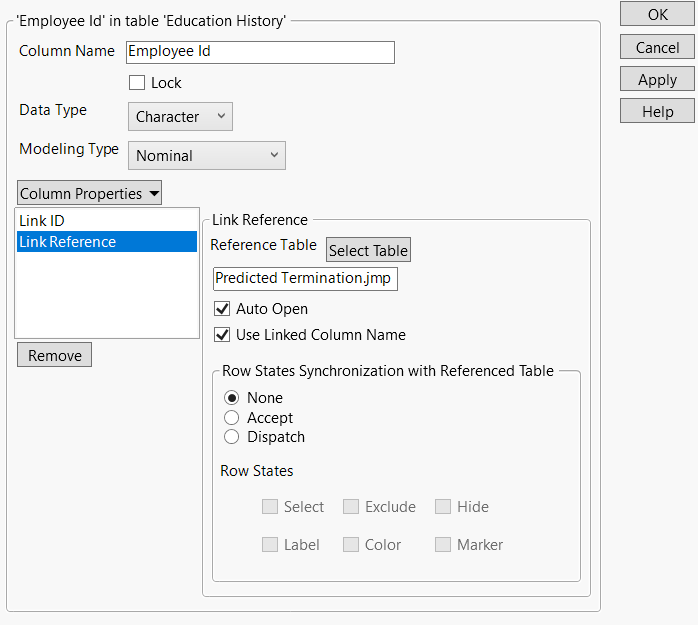

4. Open Education History.jmp from the Home Window’s Window List.
5. Select the Employee Id column and select Columns > Column Info.
Figure 6.46 Link ID and Link Reference Column Properties in Education History.jmp
As shown in Figure 6.46, Employee Id has a Link ID column property and a Link Reference to Predicted Termination.jmp.

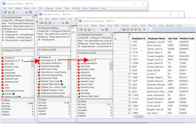

Figure 6.47 Linked Data Tables
Linked Data Tables
The Employee Id column of Employee Master.jmp references Education History.jmp, which then references Predicted Termination.jmp. All data are available through virtual join from the main data table, Employee Master.jmp.
