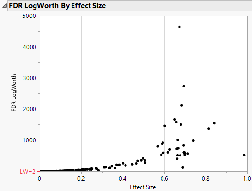

7. In the Response Screening report, open the Robust FDR LogWorth by Effect Size report.
The detail in the plot is difficult to see, because of the huge Robust FDR LogWorth value of about 58,000. To ensure that your graphs show sufficient detail, you can set a maximum value of the LogWorth.
Figure 22.12 Robust FDR LogWorth vs. Effect Size, MaxLogWorth Not Set

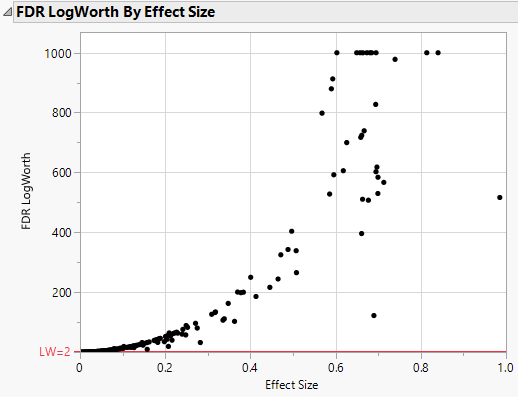

9. Type 1000 in the MaxLogWorth box at the bottom of the launch window.
10. Click OK.
The analysis might take some time to complete.
11. In the Response Screening report, open the Robust FDR LogWorth by Effect Size report.
Now the detail in the plot is apparent.
Figure 22.13 Robust FDR LogWorth vs. Effect Size, MaxLogWorth = 1000
