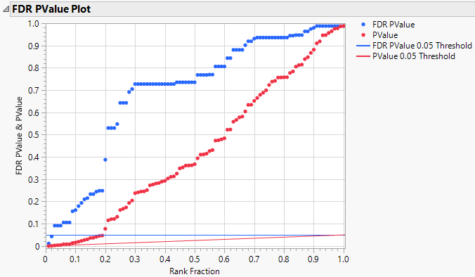

Figure 22.1 Example of a Response Screening PlotĀ
