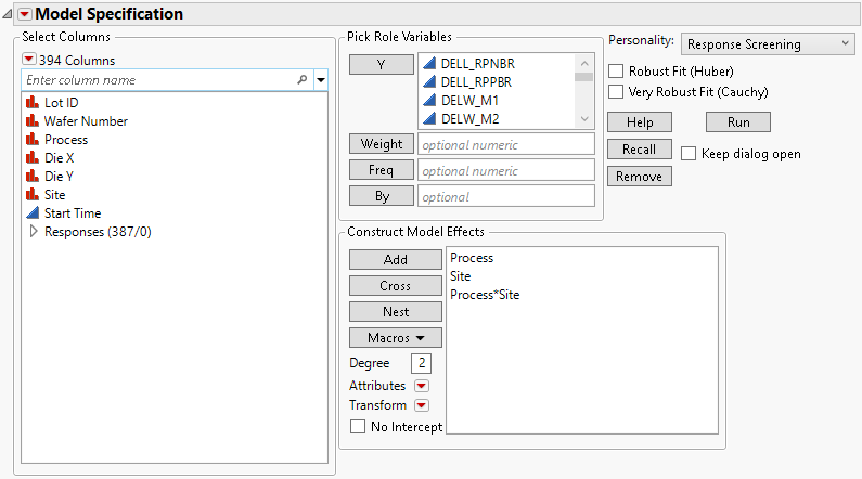

Select Analyze > Fit Model. Enter your Ys and model effects. Select Response Screening from the Personality list.
Figure 22.8 Response Screening from the Fit Model Window

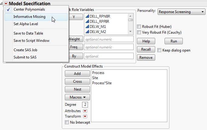

The Informative Missing option provides a coding system for missing values. The Informative Missing coding allows estimation of a predictive model despite the presence of missing values. It is useful in situations where missing data are informative. Select this option from the Model Specification red triangle menu.
Figure 22.9 Informative Missing Option
