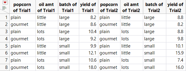

If the two tables have column names that are the same, the names of these columns in the new table appear as “column name of table name.” For example, suppose that you want to combine the eight rows from the Trial1.jmp and Trial2.jmp data tables shown in Figure 6.24 into a single table. You want to combine them so that the new table contains all of the columns from both tables.
1. Select Help > Sample Data Library and open Trial1.jmp andTrial2.jmp.
2. From the Trial1.jmp data table, select Tables > Join.
3. In the Join...with box, select Trial2.
4. From the Matching Specification menu, select By Row Number.
5. Click OK.
Figure 6.24 Original Tables and the Joined Table
A column name can be the same in the two original tables. The output column name is then qualified by the source table name. For example, the column names in the new table appear as <variable name> of table name.

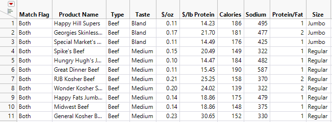

You have two files of information about hot dogs. The second file contains one column, Size, that is missing from the first file. Use Join with a matching column to combine the data tables.
1. Select Help > Sample Data Library and open Hot Dogs.jmp and Hot Dogs2.jmp.
The Product Name column is a unique identifier for the rows in your data tables. Each table has 54 unique product names.
2. From the Hot Dogs data table, select Tables > Join.
3. In the Join ‘Hot Dogs’ with list, select Hot Dogs2.
4. Select By Matching Columns in the Matching Specification area.
5. From the Hot Dogs and Hot Dogs2 lists, select Product Name.
6. Click Match.
7. In the Options, select Merge same column names. When the merge columns is used the Match Flag is automatically selected.
8. Select Keep dialog open in the lower left corner of the window so that you can easily return to the Join window in the case that the joined data table is not as you expected.
9. Click Apply.
Figure 6.29 Joined Table by Matching Columns
The resulting table now includes the Size column that was in the Hot Dogs2 table. The Match Flag column indicates that the data originated from both tables for all rows.

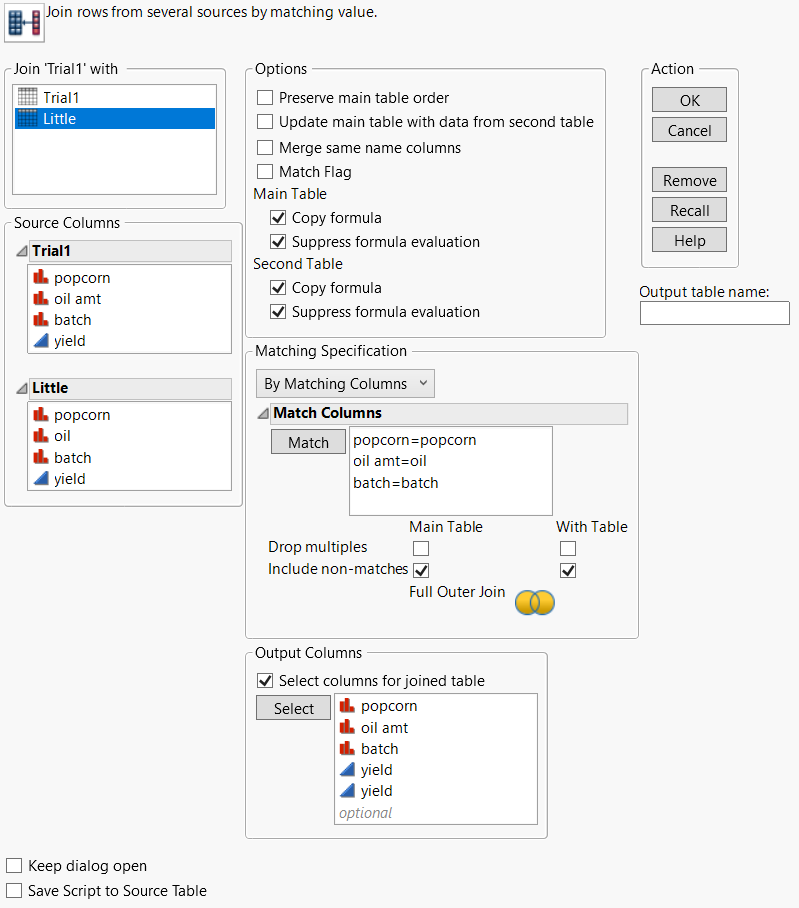

Suppose that Sarah and Joe are performing a popcorn experiment. They are popping different types of popcorn (gourmet and plain) in different amounts of oil. They are recording the amount (yield) of popcorn that is produced. Sarah gave you the first trial data in a file named Trial1.jmp. Joe gave you the second trial data in a file named Little.jmp. You want to combine the two tables into one table.
1. Select Help > Sample Data Library and open Trial1.jmp and Little.jmp.
2. From the Trial1.jmp table, select Tables > Join.
3. In the Join...with box, select Little.
You can see that three of the columns (popcorn, oil amt/oil, and batch) contain the same values in both tables. Identify these columns as matches. Also, because Sarah and Joe gave the oil and oil amt columns different names, you can tell JMP that oil amt and oil match.
4. Deselect Preserve main table order.
The joined table is sorted by matching columns, not by the order of data in Trial1.jmp,
5. Select By Matching Columns in the Matching Specification area.
6. From the Trial1 list, select popcorn, oil amt, and batch.
7. From the Little list, select popcorn, oil, and batch.
8. Click Match.

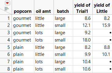

Looking at the two data tables, you can see that they have different numbers of rows. Trial1.jmp has values for eight experimental conditions, and Little.jmp has values for only four of those conditions. Sarah completed her experiment, but Joe only partially completed his experiment. You want the joined table to contain all of the rows in Trial1.jmp. even if that row in the Little.jmp table contains a missing value.
9. Select the Include non-matches boxes for both tables.
In the joined table, you want only one column for popcorn, one column for oil, and one column for batch. However, you want two columns for yield: one representing the yield from Trial1.jmp, and another representing the yield from Little.jmp.
10. Select the box beside Select columns for joined table.
11. From the Trial1 list, select all of the columns.
12. Click Select.
13. From the Little list, select yield.
14. Click Select.
Figure 6.30 Completed Join Window
15. Click OK.
Figure 6.31 Trial1.jmp and Little.jmp Joined
The joined table is sorted by the matching columns. Note that the yield column from the Little.jmp table (Yield of Little) has missing values indicating no matching values with the Trial1.jmp table.

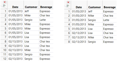

To join a table to itself (to remove duplicate entries)
1. Select Help > Sample Data Library and open Coffee Shop Purchases.jmp.
You can see that some of the customers had the same drink on the same date. You want to consolidate these duplicate rows using Join.
2. Select Tables > Join.
3. In the Join...with box, select Coffee Shop Purchases.
5. From both Coffee Shop Purchases lists, select all three columns: Date, Customer, and Beverage.
6. Click Match.
7. Select the Drop multiples boxes for both tables (the Main Table and the With Table).
8. Type Coffee Shop Purchases Final for the Output table name.
9. Click OK.
Figure 6.32 Original and Joined Coffee Shop Purchases Data Tables
