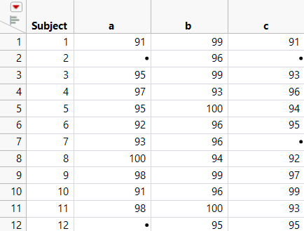

Split a Column: Grouping Rows Example
The Drug Measurements.jmp sample data table contains measurements of three different drugs (a, b, and c) administered to 12 different subjects. You want to split the measurement into different columns, one for each drug type. You also want to group the measurements by subject.
1. Select Help > Sample Data Library and open Drug Measurements.jmp.
2. Select Tables > Split.
3. Select Drug Type and click Split By.
4. Select Measurement and click Split Columns.
Notice that the Subject variable contains unequal groups. Most of the subjects were given all three drugs, but subject 2 was given only one drug, and subjects 7 and 12 were given only two drugs. In this situation, to ensure that the correct measurements are associated with the correct subject, specify Subject as the Group variable.
5. Select Subject and click Group.
6. Click OK.
Figure 6.14 Drug Measurements.jmp Split by a Grouping Variable
You can see that the appropriate missing values appear for subjects 2, 7, and 12.
