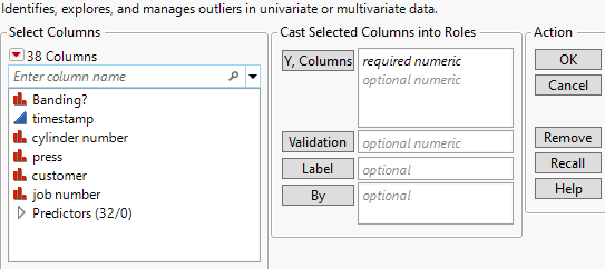

Launch the Explore Outliers Utility
To launch Explore Outliers, select Analyze > Screening > Explore Outliers.
Note: The Explore Outliers commands analyze only columns with a Continuous modeling type. Other columns can be entered in the launch window but are ignored.
Figure 21.5 Explore Outliers Utility Launch Window
Y, Columns
Specifies the columns that you want to analyze.
Validation
Specifies a validation column that is used for Robust PCA Outliers.
Label
Specifies a column that replaces row numbers in multivariate analysis reports with labels.
By
A column or columns whose levels define separate analyses. For each level of the specified column, the corresponding rows are analyzed using the other variables that you have specified. The results are presented in separate reports. If more than one By variable is assigned, a separate report is produced for each possible combination of the levels of the By variables.
