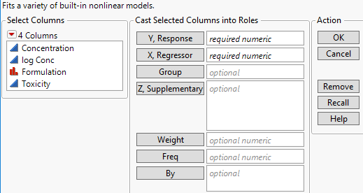

To launch the Fit Curve platform, select Analyze > Specialized Modeling > Fit Curve. The launch window is shown in Figure 14.6.
Figure 14.6 Fit Curve Platform Launch Window
The Fit Curve platform launch window has the following features:
Y, Response
Specify the Y variable.
X, Regressor
Specify the X variable.
Group
Specify a grouping variable. The fitted model has separate parameters for each level of the grouping variable. This enables you to compare fitted models and estimated parameters across the levels of the grouping variable.
Z, Supplementary
Specify one or more supplementary variables. Supplementary variables are not used in any of the calculations in the Fit Curve platform and including them does not affect the results. Supplementary variables are variables you might want to use in future analyses of the results from Fit Curve. When you specify supplementary variables, they are included in the table that is created by the Make Parameter Table option. In JMP Pro, if you specify one or more supplementary variables and a grouping variable, a Curve DOE Analysis option is made available for the fitted models. See Curve DOE Analysis.
Weight
Specify a variable that contains the weights of the observations.
Freq
Specify a variable that contains the frequencies of the observations.
By
Specify a variable to perform a separate analysis for every level of the variable.
