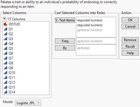

Launch the Item Analysis platform by selecting Analyze > Multivariate Methods > Item Analysis.
Figure 11.4 Item Analysis Launch Window
Y, Test Items
Assigns two or more columns to be analyzed. The columns must be numeric, continuous, and contain only 0s and 1s.

Model
Specifies the desired model from the following options:
Logistic 2PL
The 2-parameter logistic model.
Logistic 3PL
The 3-parameter logistic model.
Logistic 1PL
The 1-parameter logistic model with a Rasch parameterization.

Data Format
The Item Analysis platform requires a data table that contains a row for each individual and a column for each item. The item columns must be numeric and contain only 0s and 1s to indicate incorrect or correct responses, respectively. The MathScienceTest.jmp sample data table illustrates the required data format for an item response analysis of 1,263 individuals responses to 14 test questions.
