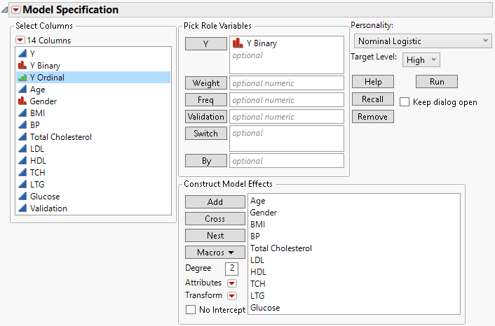

Launch the Nominal Logistic and Ordinal Logistic personalities by selecting Analyze > Fit Model and entering one or more non-continuous columns for Y. If multiple columns are entered for Y, a model for each response is fit.
Figure 11.5 Fit Model Launch Window with Nominal Logistic Selected
