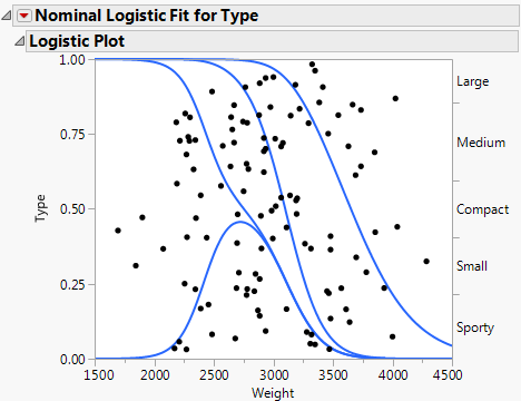

Figure 11.1 Logistic Plot for a Nominal Logistic Regression ModelĀ
