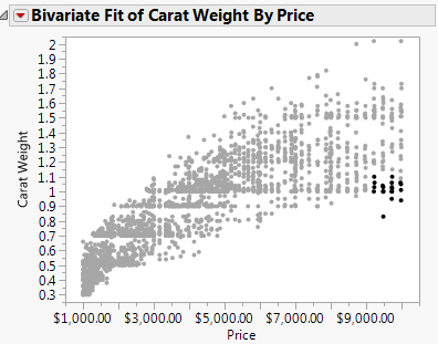

6. Select Tools > Lasso.
If you cannot see the menu bar, hover over the blue bar below the title bar to reveal it.
7. Lasso some of the points near the 10,000 dollar price at the bottom of the plot (Figure 4.9).
8. In the data table, select Rows > Next Selected (or you can press F7).
You can easily navigate through the selected rows to see the data for each.
Figure 4.9 Points Selected
Points Selected
