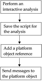

If you run the same analysis frequently, you can script it to automate the process. Anyone can then run the script, ensuring the same results every time. To get started, perform your analysis interactively as you normally would with JMP, and then save a script that re-creates that analysis. You can modify the script to further customize it.
Figure 10.1 Typical Workflow for Scripting Platforms
