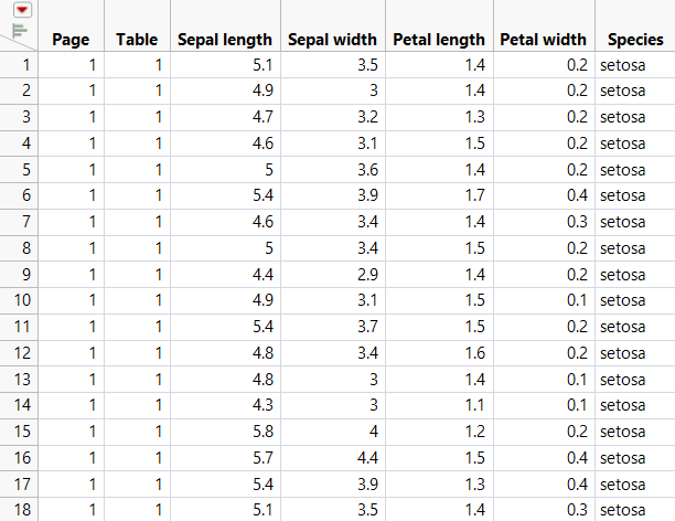

Figure 3.24 Final Data Table (Partial View)
