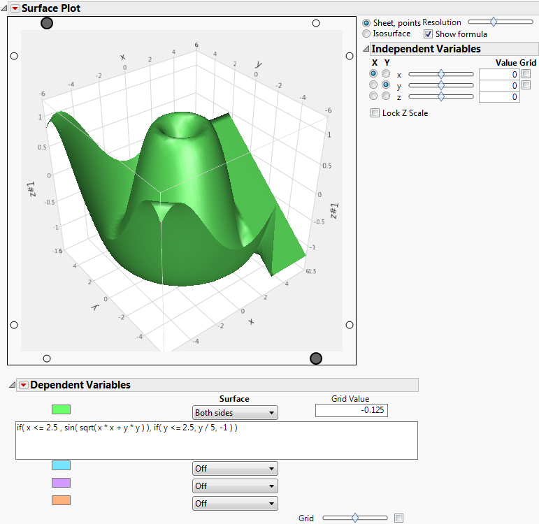

3. In the Appearance Controls, select the Show Formula check box to show the formula space.
Figure 5.13 Default Surface Plot with Formula
The default function shows in the box. To plot your own function, enter it in this box.
