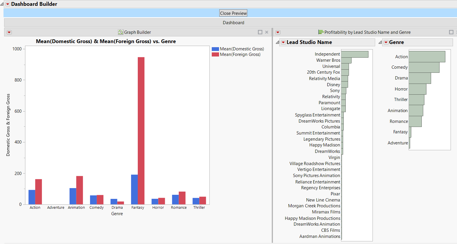

6. Click the Dashboard Builder red triangle and select Preview Mode.
A preview of the dashboard appears (Figure 11.2). Notice that the graphs are linked to each other and the data table. They also have the same red triangle options as the Distribution and Graph Builder platforms.
Figure 11.2 A Dashboard with Two JMP Reports
