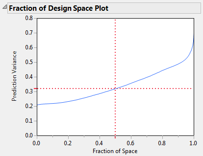

Figure 5.1 Fraction of Design Space Plot
