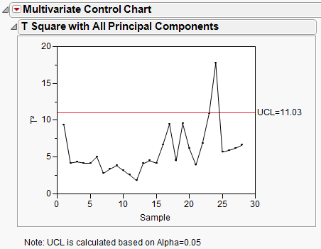

Figure 10.1 Example of a Multivariate Control Chart
