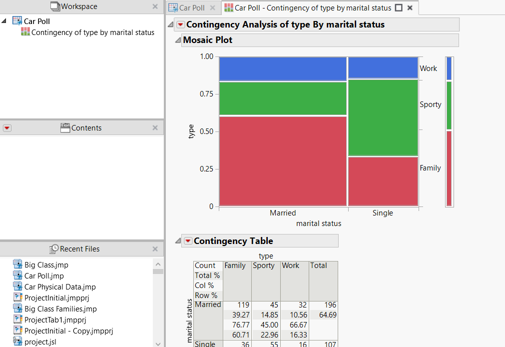

Figure 10.14 Initial Project
Initial Project
