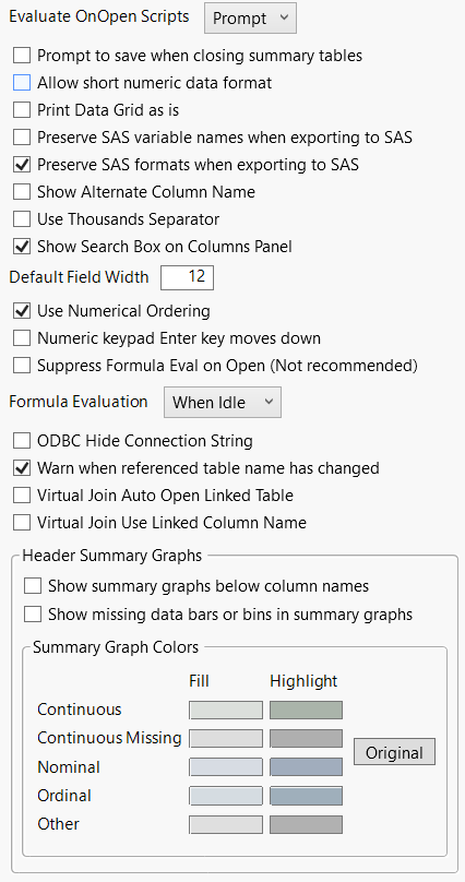

Figure 13.6 Tables Preferences
Tables Preferences
Table 13.6 Preferences on the Tables Page
