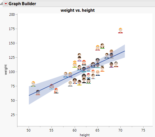

6. Create a graph that uses markers. Figure 9.23 was created in Graph Builder.
7. (Optional) To resize the markers, right-click the graph, and select Graph > Marker Size (or right-click and select Marker Size in some platforms). Medium markers are selected in this example.
8. Click the Graph Builder red triangle and deselect Show Legend.
Figure 9.23 Pictures Used as Markers
