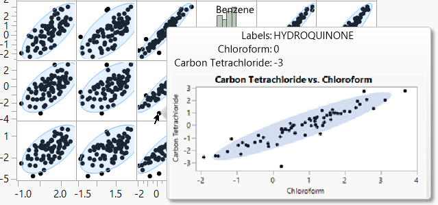

As an example, using Hover Label Execution Context variables, you can create a scatterplot matrix, hover over a point to show a close-up ellipse, and then click the ellipse to modify it in Graph Builder. The graphlet shows the same visualization as the one in the underlying scatterplot matrix cell (a scatterplot of the two columns associated with that cell).
Clicking on the thumbnail then has the effect of “extracting” the cell from the matrix and opening it up as an independent visualization.
The script shown in Example of Defining the Context of a Scatterplot Matrix and Ellipse enables the user to extract the matrix cells in the main scatterplot matrix.
Figure 12.49 Viewing an Ellipse in a Scatterplot Matrix
The following script shows an example of using the context in which the script runs. This script creates the scatterplot matrix shown in Figure 12.49.

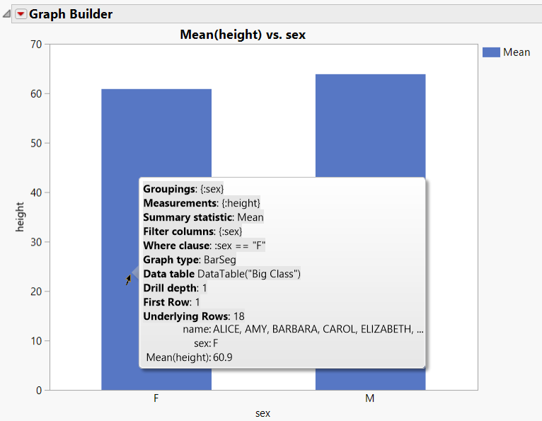

Complete Example of the Hover Label Execution Context Variables
The following script produces the graph shown in Figure 12.50. When you hover over a bar, the hover label appears. Details about the data and the Hover Label Context Execution variables appear in the log.
dt << Graph Builder(
	Size( 528, 450 ),
	Show Control Panel( 0 ),
	Variables( X( :sex ), Y( :height ) ),
	Elements( Bar( X, Y, Legend( 3 ) ) ),
	SendToReport(
		Dispatch(
			"Graph Builder",
			FrameBox,
			{Set Textlet(
				Setup(
					local:encodedWhere = XML Encode( local:_where );
					/* Show() provides additional information about the
					HLEC variables in the log */
					Show( Namespace( "local" ) << Get Contents() );
				Markup(
<b>Groupings</b>: {local:_groupings}
<b>Measurements</b>: {local:_measurements}
<b>Summary statistic</b>: {local:_summaryStatistic}
<b>Filter columns</b>: {local:_filters}
<b>Where clause</b>: {local:encodedWhere}
<b>Graph type</b>: {local:_displaySegName}
<b>Data table</b> {local:_dataTable}
<b>Drill depth</b>: {local:_drillDepth}
<b>First Row</b>: {local:_firstRow}
<b>Underlying Rows</b>: {local:_underlyingRows}
