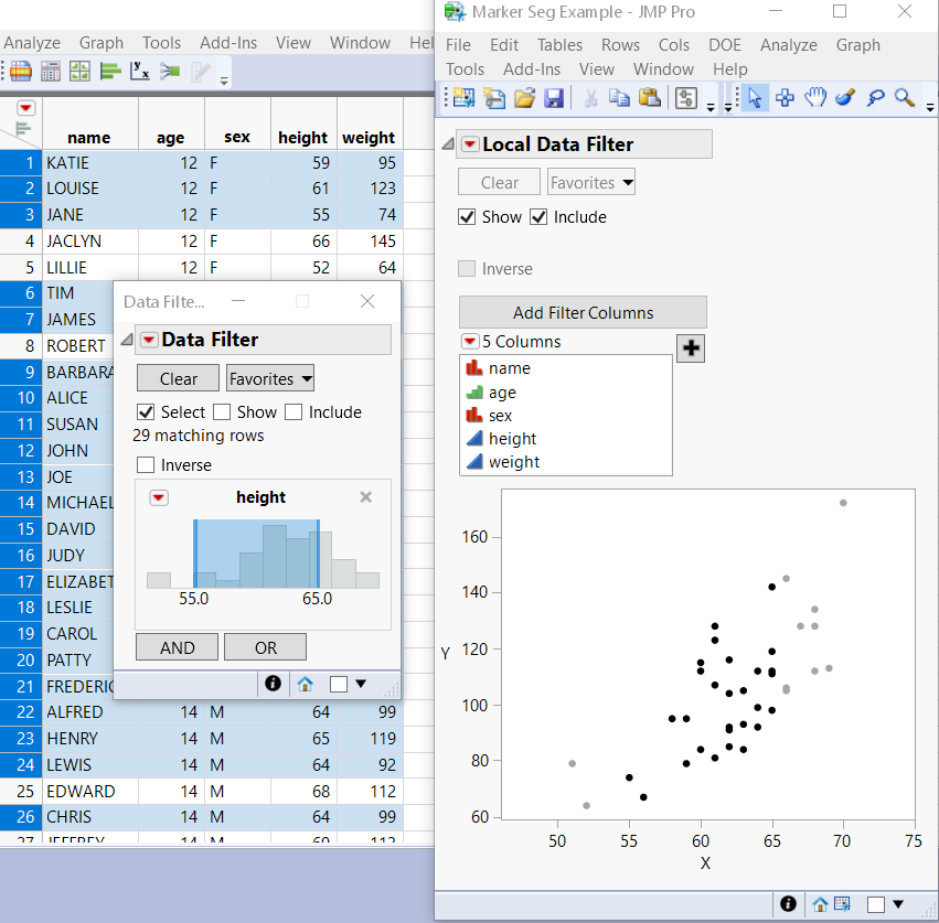

Data filters can be hierarchical. One script might generate a data filter and a local data filter. The outer data filter for the data table determines which data is available for the local data filter. To illustrate this point, the following script produces both types of data filters as shown in Figure 9.11.
Tip: The following script is part of a larger script that first builds the arrays required for a marker seg. See the Local Data Filter for Custom Graph.jsl sample script for code that builds those arrays.
New Window( "Marker Seg Example",
	Data Filter Context Box(
		V List Box(
			dt << Data Filter( Local ),
			g = Graph Box(
				Frame Size( 300, 240 ),
				X Scale( Min( xx ) - 5, Max( xx ) + 5 ),
				Y Scale( Min( yy ) - 5, Max( yy ) + 5 ),
				Marker Seg( xx, yy, Row States( dt, rows ) )
Heights greater than or equal to 55 and less than or equal to 65 are initially filtered. Then the user can work with the local data filter to filter columns on the graph.
Figure 9.11 Data Filter Hierarchy
