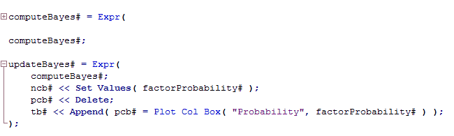

Figure 4.7 Code Folding Markers Shown in a Script
