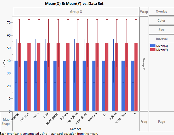

1. Select Help > Sample Data Library and open JMP Man Dozen.jmp.
3. Select X and Y and drag them to the Y zone.
4. Select Data Set and drag it to the X zone.
5. Click the Bar element Image shown here.
6. For the Error Interval, select Standard Deviation.
Figure 9.41 Original Graph for JMP Man Dozen.jmp
You can see that the mean and standard deviation for these observations are the same, so this graph does not tell you much. Use preset graphs to get more insight into the data.

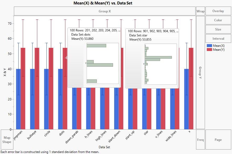

1. In the graph, right-click and select Hover Label > Histogram.
This adds preset histograms to the hover labels.
2. Point to some of the bars. In this example, point to the red bars for dots and star.
Tip: To make the hover label remain so that you can compare it with other hover labels, click the Pin icon Image shown here in the top right corner. See Pin Hover Labels in Graphs.
Figure 9.42 Example of Preset Histograms
You can see that the distribution for the measurements is clearly different. But you want to see another type of graph, a scatterplot.

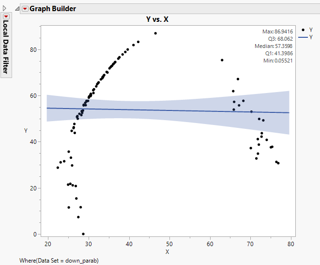

1. Hover over the blue bar for down_parab and click the graph to open it in a new window.
The graph opens in Graph Builder.
Note: Notice that when you launch a preset graph, you see a Local Data Filter at left. You can use the Local Data Filter to expand and modify the graph. For details, see Local Data Filters in Reports.
2. Click the Graph Builder red triangle and select Show Control Panel.
3. Click the Line of Fit element Image shown here.
4. Click the Caption Box icon Image shown here.
5. Under Caption Box, change the Summary Statistic to 5 Number Summary.
6. Click Done.
Figure 9.43 Customized Graph for down_parab

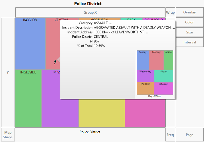

5. Right-click on the graph and select Hover Label > Treemap.
6. Put your cursor over Central to see the hover label graph.
Figure 9.44 Initial Hover Label Graph for Central
The hover label graph is showing the number of incidents in each district by the day of the week. Instead, in this example, you want to see the number of incidents in each district by category.

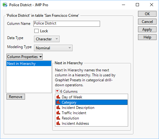

1. In the San Francisco Crime.jmp data table, right-click the Police District column heading and select Column Properties > Next in Hierarchy.
2. Under Next in Hierarchy, click Category.
Figure 9.45 Category Selected for Next in Hierarchy
3. Click OK.

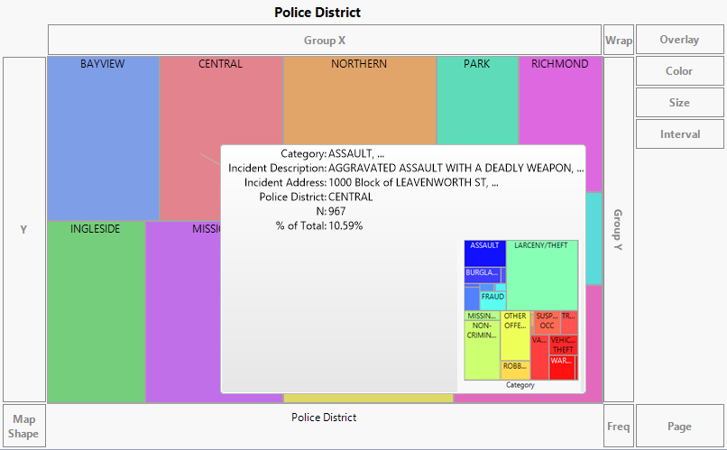

4. Add a second level of the hierarchy that appears if the first hover label graph is launched:
a. In the San Francisco Crime.jmp data table, right-click the Category column.
b. Select Column Properties > Next in Hierarchy.
c. Under Next in Hierarchy, click Incident Description.
d. Click OK.
5. In Graph Builder, put your cursor over Central again to see the updated hover label graph.
Figure 9.46 Updated Hover Label Graph for Central
The hover label graph is now showing the number of incidents in each district by category.

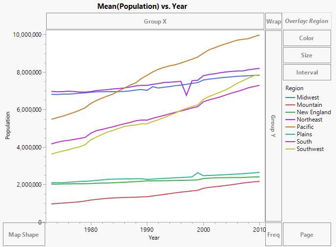

1. Select Help > Sample Data Library and open CrimeData.jmp.
These data show crime rates for regions and states in the U.S.
3. Select Population and drag it to the Y zone.
4. Select Year and drag it to the X zone.
5. Select Region and drag it to the Overlay zone.
6. Click the Line element Image shown here.
Figure 9.48 Mean Population Crime Rates by U.S. Region Per Year
This graph shows the mean population in each U.S. region that were impacted by different crime rates over different years. In the hover label graphs, you want to see a more granular view that shows the impacts by U.S state instead of region.

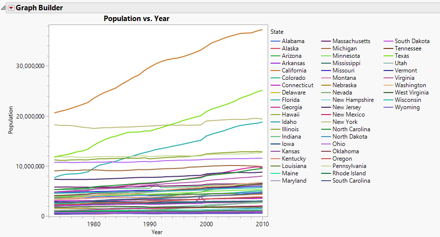

2. In the copy of the graph, select State and drag it to the Overlay zone.
This replaces Region with State.
3. Click Done.
Figure 9.49 Mean Population Crime Rates by U.S. State Per Year

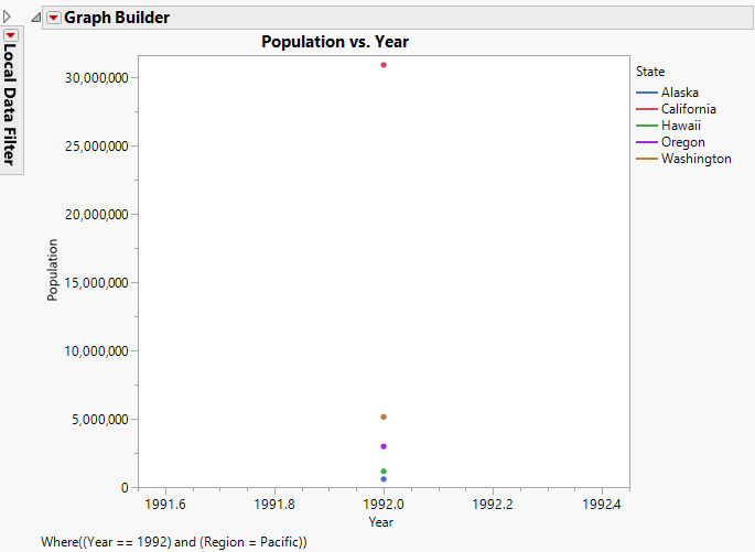

7. Hover over the Pacific line and click to launch the hover label graph.
Figure 9.50 Hover Label Graph Showing Crime Rates by State and Year for the Pacific Region
Because we are still filtering by year, this view is too granular to be useful. You want to remove the year filter, so the graph filters only by region.

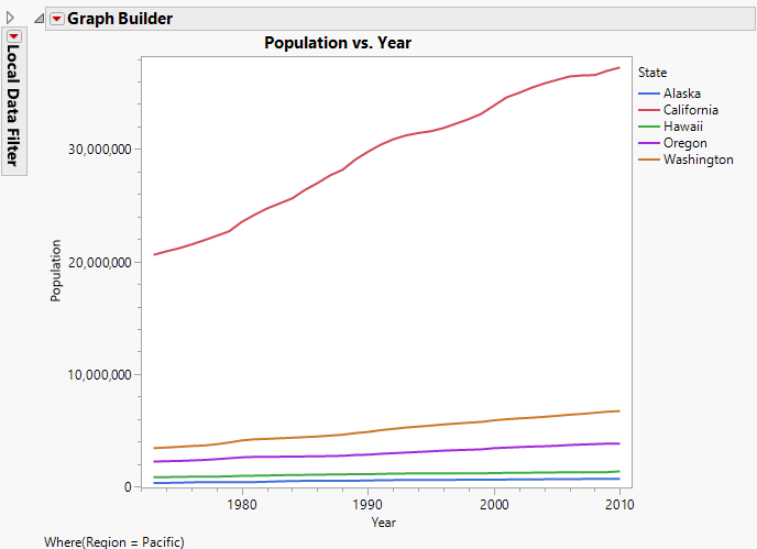

5. Hover over the Pacific line and click to launch the hover label graph.
Figure 9.52 Hover Label Graph Showing Crime Rates by State for the Pacific Region
You can see that the hover label graphs are no longer filtering by year, but by region only, creating a more useful visualization.

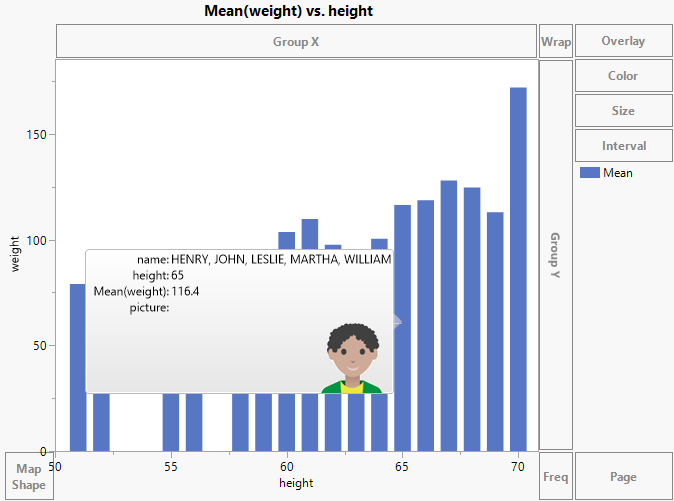

6. Hover over the bar for the height of 65 inches and click Pin Image shown here.
Figure 9.53 Hover Label with Only Initial Image
Although five names are included in this bar, only the first image (Henry) appears in the hover label. You want to see more images in the hover label.
