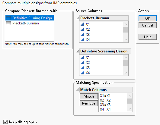

3. In the Plackett-Burman data table, select DOE > Design Diagnostics > Compare Designs.
4. Select Definitive Screening Design from the Compare ‘Plackett-Burman’ with list.
5. Select X1 through X6 in the Plackett-Burman panel and in the Definitive Screening Design panel.
6. Open the Match Columns outline and click Match.
Figure 16.2 Launch Window with Matched Columns
This defines the correspondence between the factors in your two designs.
7. Click OK.

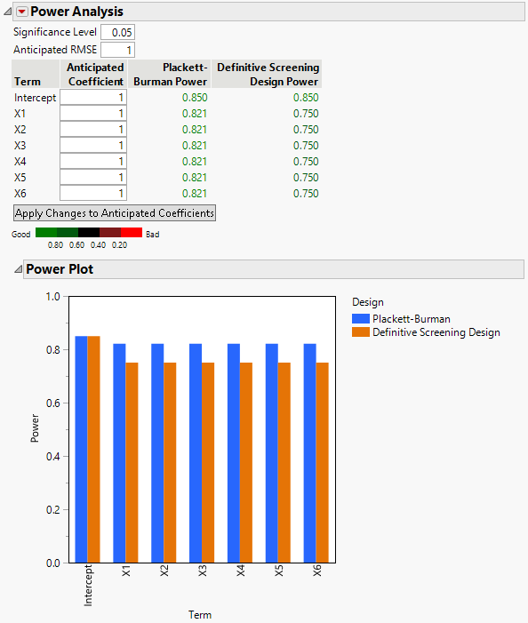

Figure 16.3 Power Analysis for PB and DSD Comparison
In terms of power, prediction variance, and estimation efficiency, the PB design outperforms the DSD. Figure 16.3 shows the Power Analysis report with the default settings for the significance level, Anticipated RMSE, and coefficients. For tests for the main effects, the PB design has higher power than does the DSD.

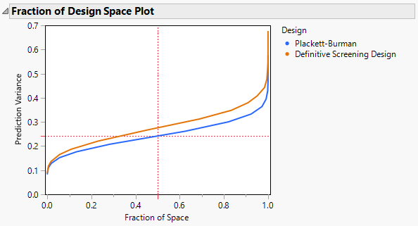

Figure 16.4 Fraction of Design Space Plot for PB and DSD Comparison
The Fraction of Design Space plot indicates that the PB design has smaller prediction variance than the DSD over the entire design space.
You conclude that, if you suspect that only main effects are active, the PB design is preferable.

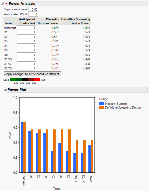

Figure 16.6 Power Analysis for PB and DSD Comparison with Interactions
The Term list shows the three two-way interactions. If these two-way interactions are active, then the DSD has better performance in terms of power across all effects than the PB.

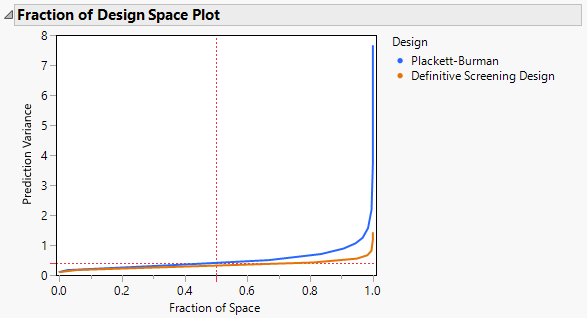

Figure 16.7 Prediction Variance for PB and DSD Comparison with Interactions
The DSD also outperforms the PB design in terms of prediction variance with the three interactions in the model. You can explore the other reports to see that the DSD is preferred when there are potentially active interactions.
