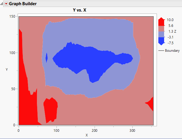

You can create the same contour plot shown in Figure 10.2 using Graph Builder.
1. Select Help > Sample Data Library and open Little Pond.jmp.
3. Click and drag the X coordinate to the X zone.
4. Click and drag the Y coordinate to the Y zone.
5. Click and drag depth, Z, to the Color zone.
6. Click the Contour Image shown here icon.
Figure 10.3 Contour Plot in Graph BuilderĀ
Notice the plot produced from the Contour platform looks slightly different than the plot produced using Graph Builder.
