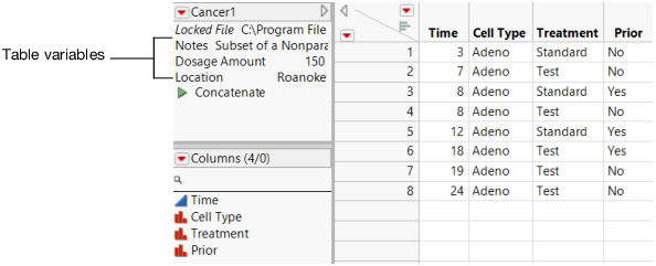

Figure 4.61 Table Variables in the Table Panel
Uses for Table Variables
Use table variables in the following situations:
• To document tables
• In formulas
• In JSL scripts
Use Table Variables to Document Tables
Table variables are used primarily to document tables. Many sample data tables installed with JMP contain a table variable named Notes. This variable provides details about the data (for example, the source of the data). The example in Figure 4.61 shows a data table that contains Notes as one of its table variables. JMP also automatically creates table variables when you create a design table using the Design of Experiments commands in JMP. The design table has a table variable named Design with the name of the design type as its value.
