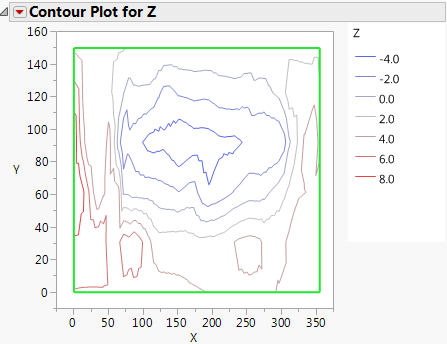

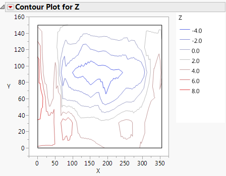

1. Select Help > Sample Data Folder and open Little Pond.jmp.
2. In the Table panel, click the green triangle next to the Contour Plot script.
3. Click the red triangle next to Contour Plot for Z and deselect Fill Areas.
Figure 9.33 Contour Plot before Customization
4. Right-click the plot and select Customize.
The Customize Graph window appears.
5. Click Shape.
6. Change the Line Width to 2.0.
7. Click the color next to Line Color and select a shade of green.
8. Click OK.

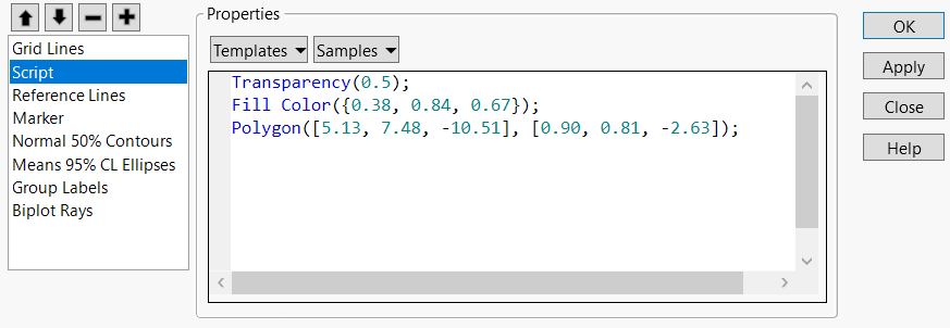

• Use the Samples list to insert a script that creates elements such as bubble plots and sine waves. In this list, the Polygon sample script shows examples of the Transparency, Fill Color, and Polygon values, which you replace with your own values.
Figure 9.36 The Polygon Sample Script

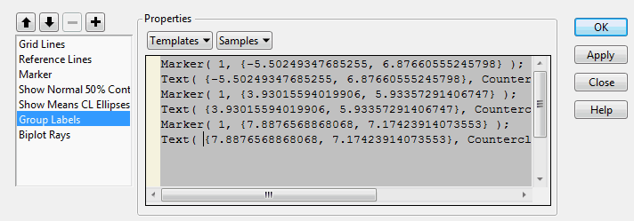

In some graphs, you can view the JSL that creates graphical elements. Figure 9.37 shows the Group Label script for a Discriminant Analysis graph. The script defines markers and text for group labels. The commands included in these built-in scripts cannot be modified or deleted. You can insert commands from the Templates or Samples list, but you cannot click in the window and type new commands.
Figure 9.37 Example of JSL That Creates Group Labels
For information about JSL, see the Scripting Guide and the JSL Syntax Reference.
