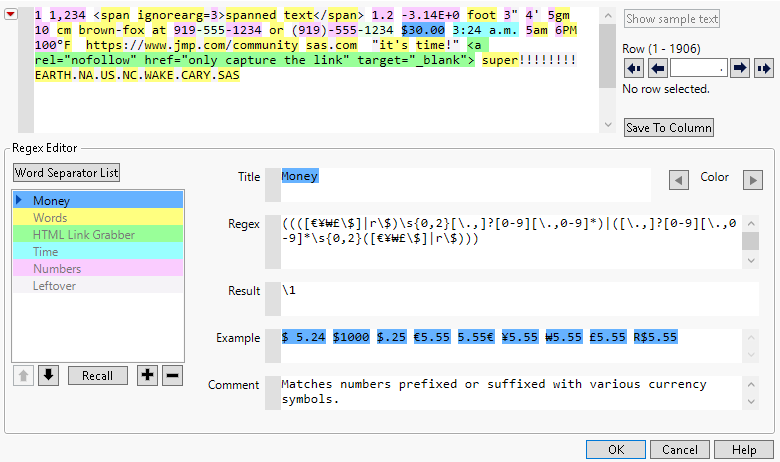

When you select the Customize Regex option, the Text Explorer Regular Expression Editor appears. Use this window to parse text documents using a wide variety of built-in regular expressions, such as phone numbers, times, or monetary values. You can also create your own regular expression definitions.

Figure 12.7 Text Explorer Regular Expression Editor
Parsing with the Script Editor Box
The script editor box at the top of the window shows you how the parsing would proceed for sample text. The results of parsing the regular expressions in the Regex Editor list are highlighted in colors that correspond to the colors in the Regex Editor list.
• Click the First, Previous, Next, and Last row buttons to populate the script editor box with text from your own data. This enables you to see how a given row of text data is parsed. You can also enter a row number in the edit box to populate the script editor box with text from a specific row in the data table.
• Click the Save to Column button to save a new column to the data table that contains the result of the regular expression tokenization. For more information about specifying the result of the regular expression, see Editing the Regular Expressions. The Save to Column button does not appear if you access the Regular Expression Editor through Cols >Utilities > New Column by Text Matching.
Note: The Save to Column button uses only the regular expression to match text. The following settings are not used: stop words, recodes, stemming, phrases, or minimum and maximum characters per word to modify the output of the regular expression.

Terms are tokenized by processing the regular expressions in the order specified in the Regex Editor panel. To change the order of the regular expressions, select a regular expression in the list and click the up or down arrow buttons below the list. You can also drag and drop items in the regular expression list to change the order of execution. A blue triangle represents the currently selected regular expression. To remove a regular expression and exclude it from the tokenization, select it in the list and click the minus sign below the list. The “Leftover” regular expression cannot be removed and must appear last in the sequence of regular expressions.
When you select a regular expression in the list, the editable fields in the Regex Editor panel refer to the selected regular expression. Click and type in any of these fields to edit them.
Each regular expression has the following attributes:
Title
Specifies a name used to identify the regular expression in the current window (as well as in the Regex Library later).
Regex
Specifies the regular expression definition. The regular expression must have at least one set of parentheses to designate the regular expression capture.
Result
Specifies what replaces the text matched by the regular expression. This value can be static text, blank, or the value of the regular expression capture. The regular expression capture is defined as the result of the Regex definition:
– To replace the matched text with static text, specify the static text in the Result field.
– To ignore the matched text, leave the Result field blank.
– To keep the text that results from the outer-most parentheses in the regular expression, use “\1” (without quotation marks) in the Result field.
– To keep the entire result of the regular expression, use “\0” (without quotation marks) in the Result field.
Example
(Optional) Specifies an example text string with colors indicating the behavior of the regular expression.
Comment
(Optional) Specifies a comment to explain the regular expression and its behavior.
Color
Specifies the color used to identify matches of the regular expression in the text in the Script Editor box and in the Example field. Use the arrow buttons to change the color.
Note: If the regular expression definition in the Regex field is invalid, a red X appears next to the name of the regular expression in the list of regular expressions.
