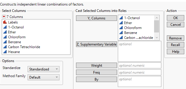

Launch the Principal Components platform by selecting Analyze > Multivariate Methods > Principal Components. Principal Component analysis is also available using the Multivariate and the Scatterplot 3D platforms.
The example described in Example of Principal Component Analysis uses all of the continuous variables from the Solubility.jmp sample data table.
Figure 4.3 Principal Components Launch Window
Y, Columns
The variables to analyze for components.

Standardize
Specifies whether each column is centered and standardized. This determines what matrix is used to calculate the principal components.
Standardized
Centers and standardizes each column individually. The principal components are calculated based on the correlation matrix.
Unscaled
Centers each column individually. The principal components are calculated based on the covariance matrix.
Unscaled and Uncentered
The principal components are calculated based on the unscaled and uncentered matrix.
Method Family
Specifies the type of data.
Default
If the number of columns is less than 500 or less than the number of rows, Narrow Data is specified as the Method Family. If the number of columns is greater than 500 and greater than the number of rows, a wide estimation method is recommended by a JMP alert window. Click Wide Method (fast) to use to a wide data estimation method or click Default Method (slow) to use a narrow data estimation method.
Narrow Data
Uses the covariance matrix, correlation matrix, or unscaled and uncentered matrix to obtain the principal components.
Wide Data
Uses singular value decomposition to obtain the principal components.
