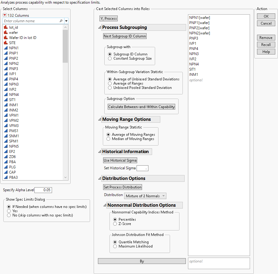

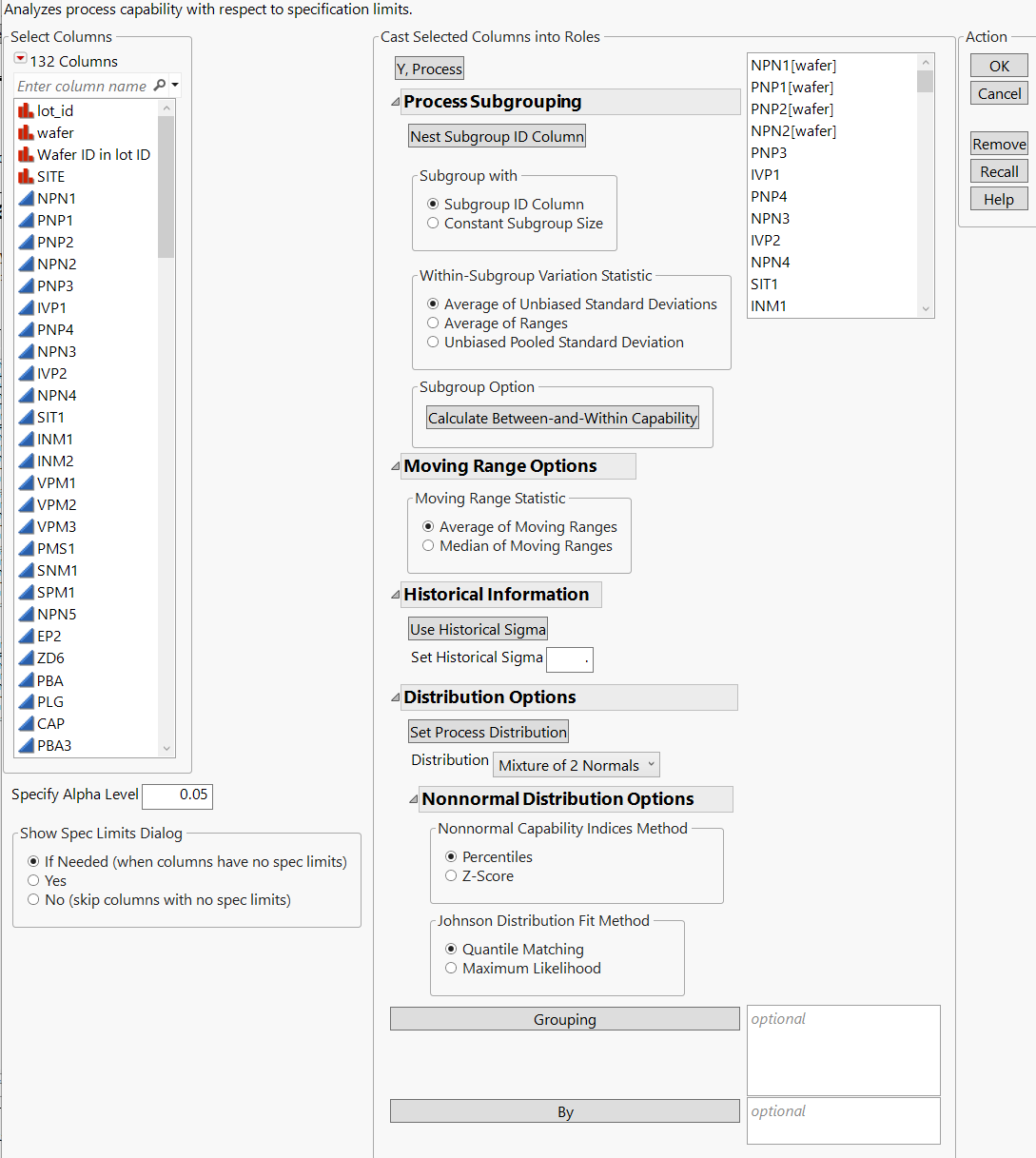

Launch the Process Capability Platform by selecting Analyze > Quality and Process > Process Capability. In Figure 9.6, all sections and panels have been opened.
Figure 9.6 Process Capability Launch Window
The Process Capability launch window contains the following outlines and options:
• Process Selection
• Process Subgrouping
• Moving Range Options
• Historical Information
• Distribution Options
• Other Specifications
After you click OK in the launch window, the Spec Limits window appears unless one of the following occurs:
• All of the columns contain specification limits.
• You selected No (skip columns with no spec limits) on the launch window.
The Spec Limits window also appears if you select Yes on the launch window. Otherwise, the Process Capability report window appears.
