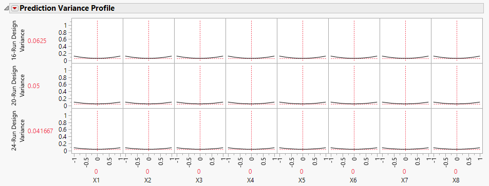

Figure 17.23 Prediction Variance Profile for Three Designs
The Prediction Variance Profile plot in Figure 17.23 is for the three designs constructed in Example Using Designs of Different Run Sizes. Two two-way interactions, X1*X3 and X2*X3, have been added to the Model section. The initial value for each continuous factor in the plot is the midpoint of its design settings. The Variance values to the left indicate that, as the number of runs increases, the variance decreases at the center point.

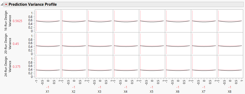

Figure 17.24 Prediction Variance Profile Showing Maximum Variance for Three Designs
Figure 17.24 shows the Prediction Variance Profile after Maximize Variance was selected for the three designs constructed in Example Using Designs of Different Run Sizes. As expected, the maximum relative prediction variance decreases as the run size increases. The plot also shows values of the factors that give this worst-case relative variance. However, keep in mind that many settings can lead to this same maximum relative variance.
