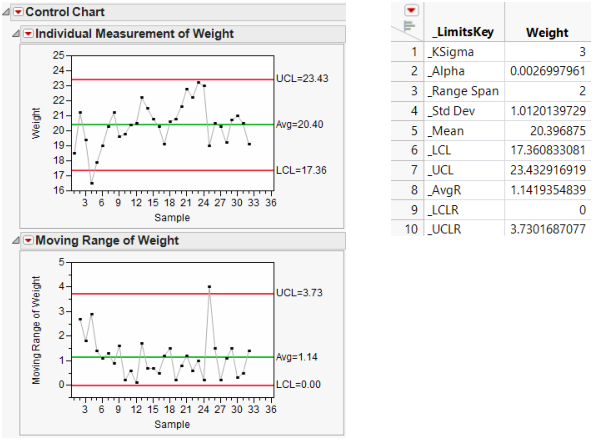

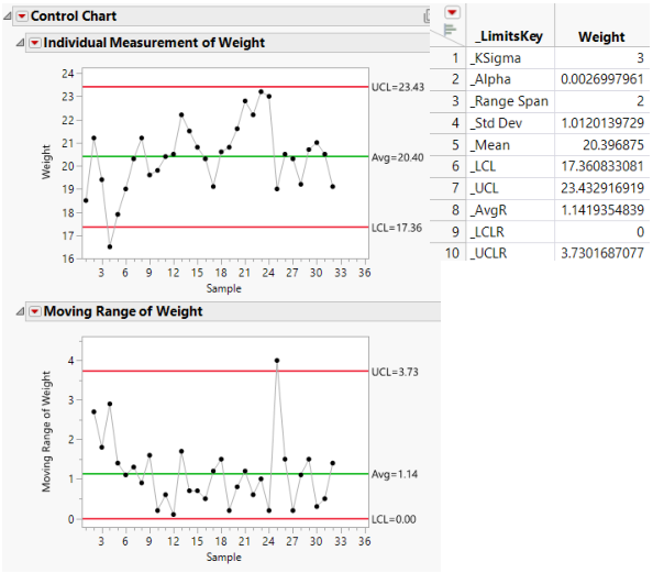

You can save limits in a new data table or as properties of the response column. When you save control limits using the in New Table command, the limit keywords written to the table depend on the current chart types displayed.
Figure 14.16 shows examples of control limits saved to a data table using Coating.jmp. The rows with values _Mean, _LCL, and _UCL are for the Individual Measurement chart. The values with the R suffix (_AvgR, _LCLR, and _UCLR) are for the Moving Range chart. If you create these charts again using this Limits Table, the Control Chart platform identifies the appropriate limits from keywords in the _LimitsKey column.
Figure 14.16 Example of Saving Limits in a Data Table
Note that values for _KSigma, _Alpha, and _Range Span can be specified in the Control Chart Launch window. JMP always looks at the values from the window first. Values specified in the window take precedence over those in an active Limits Table.
Rows with unknown keywords and rows marked with the excluded row state are ignored. Except for _Range Span, _KSigma, _Alpha, and _Sample Size, any needed values not specified are estimated from the data.
