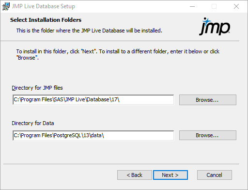

Figure 1.2 Specify Installation Folders
Specify where to install the JMP Live database and the PostgreSQL database:
Click Next to accept the default location.
Click Browse to change the default installation folder.
Note: Make sure you have adequate space in the directory where you install the PostgreSQL database.

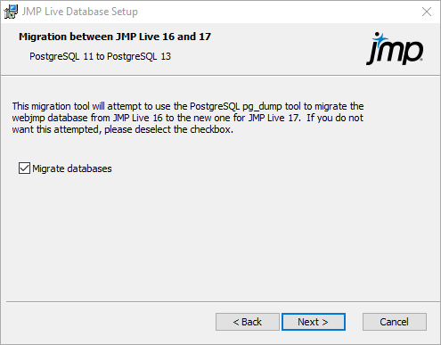

Figure 1.8 Choose a Migration Process
5.
Choose a migration process:
If you are not familiar with migrating databases, it is recommended to leave Migrate databases selected.
If you are familiar with migrating databases, it is recommended to deselect Migrate databases and do a manual migration, since this allows for more customization. It is recommended to follow the PostgreSQL documentation for database backup and restoration.

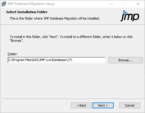

Figure 1.11 Specify Installation Folder
8.
Specify where to install the JMP Live Database Update installer:

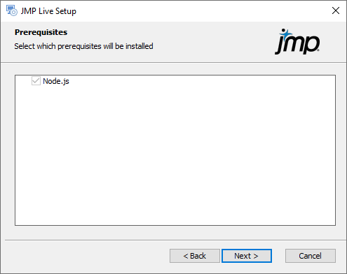

Figure 1.29 Select Prerequisites to Install
Node.js is selected by default and must be installed.
6.
Click Next.

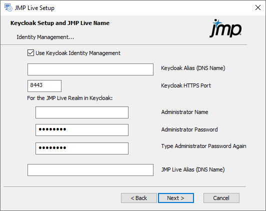

Figure 1.36 Set Up Keycloak
Note: Instead of using Keycloak, it is possible to add a direct connection to Microsoft Active Directory. See Configure Advanced Settings. Please be advised that this method will not be supported in future versions of JMP Live.
15.
Specify the following Keycloak settings:
Use Keycloak Identity Management: Enables the Keycloak authentication system. If you deselect this option, Local authentication is used. In this case, users need to create accounts in JMP Live. These users will not be authenticated against different identity providers. For details about connecting Keycloak to your identity provider, see the Keycloak documentation.
Keycloak Alias (DNS Name): Specify the name of the server machine that is running the Keycloak authentication service.
Keycloak HTTPS Port: Specify the number of the port that Keycloak expects to receive requests on. The default port is 8443.
Administrator Name: Specify the administrator name for the JMP Live realm in Keycloak. The realm keeps JMP Live credentials separate from any other software applications that might be using Keycloak authentication.
Administrator Password: Specify the administrator password for the JMP Live Keycloak realm.
JMP Live Alias (DNS Name): Specify the name of the machine that will be running the main JMP Live site.

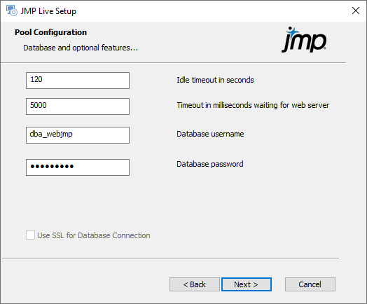

19.
Specify these JMP details:
Idle timeout in seconds: Enter the length of time that a JMP instance waits for additional work before dropping the connection with the JMP web component and waiting for a new request.
Timeout in milliseconds waiting for web server: Enter how long an instance waits for further communication during an existing transaction before it gives up and discards the existing work request.
Database username: Specify the user name of the database administrator.
Database password: Specify the password of the database administrator.
SSL Root Certificate: (Appears if you are installing the JMP Pool Manager component only) Specify the location of your organization’s certificate authority file.

Keycloak Application
The Keycloak application acts as a bridge to various authentication mechanisms. OpenID Connect (OIDC) is used between the JMP Client, JMP Live, and Keycloak to secure those transactions. The connection between Keycloak and the various authentication mechanisms depends on that mechanism, but it is often TLS.
Keycloak provides authentication session tokens to JMP Live and JMP. These tokens indicate whether the user is allowed to use JMP Live. The tokens also tell JMP Live when the authentication session has expired.
Use Active Directory or LDAP
To enable on-premises authentication using Active Directory or LDAP, you need to specify certain parameters in the environment file for the JMP web component.
Open the environment file for the JMP web component, located here (by default): C:\Program Files\SAS\JMP Live\JMPLive\.env.
If you have installed the JMP web component as a Windows service, use the Task Manager to stop the service before you update the environment file.
Specify these parameters in the .env file:
AUTH_SCHEME=ldap
This specifies the authentication method as LDAP or Active Directory.
LDAP_URL="ldap://site_ldap_endpoint.mycompany.com:port#"
This is the communication endpoint for the Active Directory requests, where port# is the 4-digit port used for the Active Directory communications. The connection must be direct to the Active Directory or LDAP instance.
LDAP_BIND_DN="CN=COMPANY LDAP-Read,OU=Generic and Shared Accounts,OU=Admin,DC=mydepartment,DC=mycompany,DC=com"
This is the administrator account for the Active Directory binding. This is site specific. If your site does not allow for anonymous binding, this might be a domain-specific account.
LDAP_SEARCH_BASE="DC= mydepartment,DC= mycompany,DC=com"
This is the base domain from which to search for users by user name.
LDAP_BIND_CRED="abcd1234efgh"
This is the administrator account password
LDAP_SEARCH_FILTER=(samAccountName={{username}})(memberOF=CN=JMP Live User Group,OU=Groups,DC=mydepartment,DC=mycompany,DC=com))
The filter used to search for the user. The user name in {{}} is interpolated as the provided user name. You can use the memberOF option to validate that a user is in the group.
Save the .env file.
5.
If you have installed the JMP web component as a Windows service, use the Task Manager to restart the service once you finish updating the environment file.

If you are using the JMP Live database as the Keycloak database, run JMP Live once.
This populates the JMP Live database with the correct schemas and tables for Keycloak to operate.
If JMP Live is running as a Windows service, stop it:
a.
Type Task Manager in the Windows search bar. Or, press Ctrl+Alt+Delete and select Task Manager.
b.
Click the Services tab.
Tip: If you do not see the Services tab, you might need to click More Details.
c.
Right-click webjmpsvc.exe and jmppoolsvc.exe and click Stop.
Type Command Prompt in the Windows search bar. Run the command prompt as an administrator (right-click Command Prompt and choose Run as administrator).
Navigate to the JMPLive component installation directory. Enter: cd C:\Program Files\SAS\JMP Live\JMPLive (assuming that JMP Live is in the default directory).
5.
Edit the .env file using Notepad. Enter: start Notepad .env.
6.
In the .env file, verify the parameters in these lines:
AUTH_SCHEME=keycloak
Note: Alternative choices include ldap and local. ldap is the legacy choice to connect to LDAP or the Microsoft Active Directory (do not choose this option unless you are using JMP 15.0 or higher). local allows for a stand-alone authentication without connecting to an identity provider.
KEYCLOAK_SERVER_URL=https://mykeycloakserver.mydomain.com:8443
Where mykeycloakserver.mydomain.com:8443 is the URL of your Keycloak server and the port that allows HTTPS access.
KEYCLOAK_ADMIN=keycloakadmin
Where keycloakadmin is the administrator name for the JMP Live realm in Keycloak.
KEYCLOAK_ADMIN_CREDENTIALS=Password1
Where Password1 is administrator password for the JMP Live Keycloak realm.
JMPLIVE_BASEURL=https://myjmpliveinstance.mydomain.com:3501
Where myjmpliveinstance.mydomain.com:3501 is the DNS name or alias of your JMP Live server and the port that you are using for HTTPS access.
7.
Save the .env file updates. Click File > Save.
8.
Start the JMP Live components:
If you installed JMP Live as a Windows service, open the Task Manager, Services tab (refer to step 2) and start each JMP Live service. Right-click webjmpsvc.exe and jmppoolsvc.exe and click Start.
If you have not installed JMP Live as a Windows service, perform the steps under Components Not Installed as Windows Services.
JMP Live and Keycloak should now be working together.
